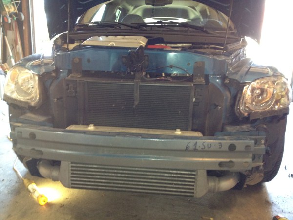

If you remove the front fascia it is an easy install, I followed the Chinese instructions.
Like Prod say's very important to aim them down if you don't use projectors.
