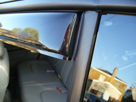

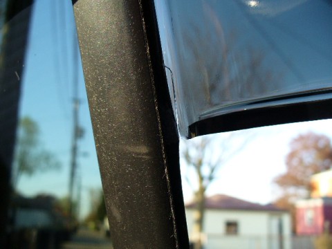

Just noticed
Originally Posted by FXM
I just attached my four vent visors on the "Chiller". They are the ones that are attached with 3M tape, Well, after they are installed, I noticed that the drivers side (back window) vent visor is cracked. How do I remove the broken visor so I can replace it?
Thanks
Doog Si Efil
F.X.
I just reread this and low and behold, that`s the same vent that cracked on me.
The rear drivers side, back where the rubber strip seperates the two windows?
From the outside it`s hardly noticable.

Yeah, in-channel. I think the load on the end helped crack it.
Maybe the stick-on type will fair better, just showing the area for reference.
