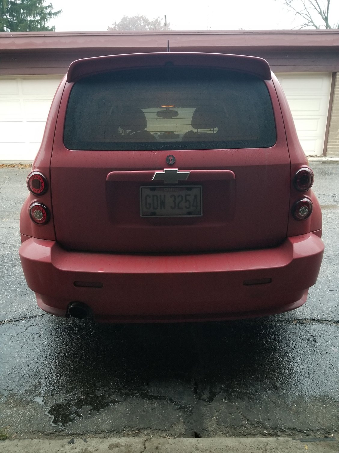

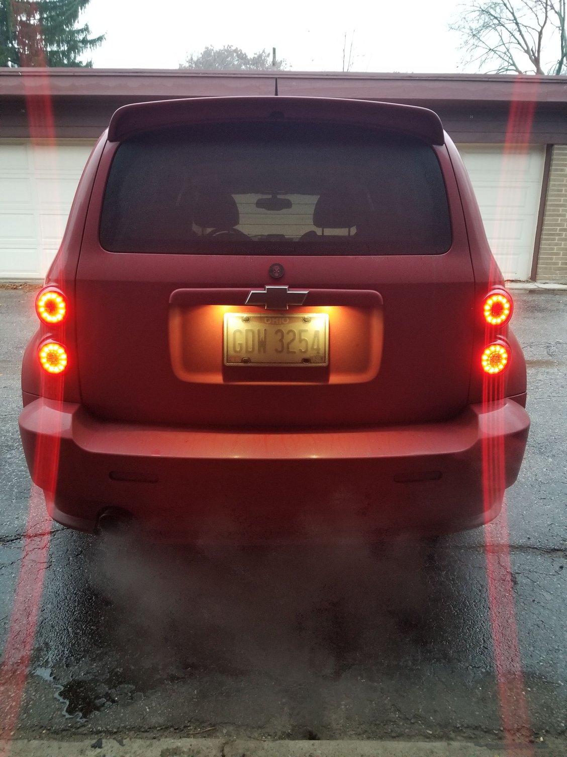

they do look better on the clean car of course
They look great!
Can't tell from photos... are they Brighter than the standard tail lights?
Bright from behind... Anything grabbing the attention from behind, the Better!
Related, is there a LED light for the 3rd Brake light, I've seen some that strobe for 3rd brake light.
Like the Rear Chevy Emblem, where did you find that... was going to remove the bowtie and replace with older signage until I realized the base was also bow tie shaped. The Emblem with older Chevrolet within it is pretty cool.

Yes, they are noticeably brighter. Especially the reverse.
