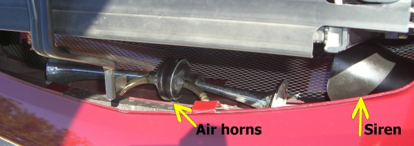

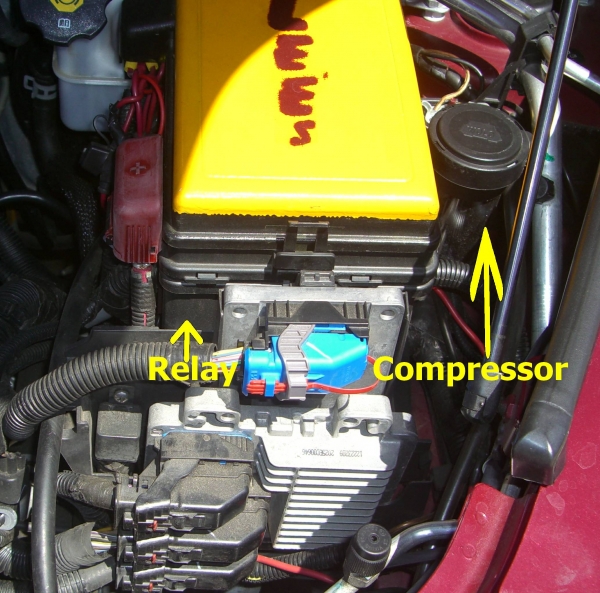

This is how I did mine. I had 2 airhorns (and a siren) that I originally mounted inside the engine compartment to the plastic cover over the computer. I later moved it in front of the radiator using metal brackets attached to the existing bolts. I just found the right thread size and added a nut on top (there was enough of the threads available). I think this is the best location, since it is not very noticable and in the best position for a loud sound outside.
The compressor and relay use power from the post alongside the fuse box. I only had to run one trigger wire inside to a switch I added, then I ran another wire to a ground bolt (next to the interior fuse box).
