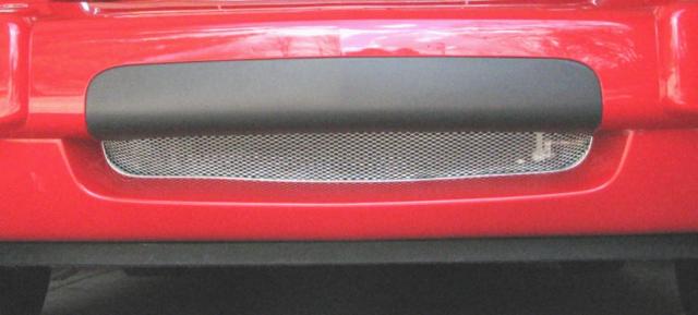

I used the gutter guard from Home Depot, cost $2.39. Then I cut the mesh to measure 32". Next, I stuck the mesh behind the front bumper,marked my lines, folded the mesh over the top lip and then the bottom lip. Attached the mesh grill using mechanics wire. I poked three small holes using a push pin on the lower lip of the bumper. then ran the wire through the holes and twisted them together for a nice tight fit.

Just another "me too" addition to the gutter guard grill gang.

Did this today! Need some right-sized nuts to finish it off, but it looks GREAT as is! Left it natural metal, but paint is not out of the question...

Just finished adding this mod to our new (to us) 06 LT with my son. Grand total: $4.07! Well worth it, as I have a bad track record with A/C condensors. Left the mesh unpainted for now, and it looks pretty good against the sandstone body.
