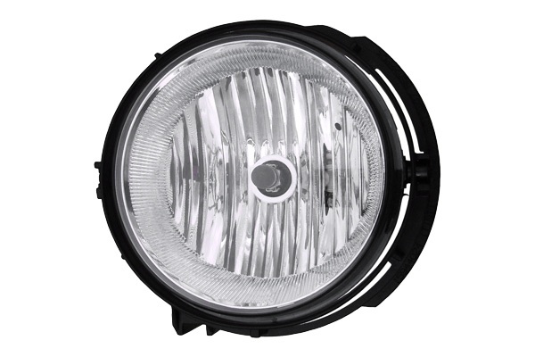

I found some pictures of the two to help everyone understand and maybe someone out there will know why the fog light was redesigned
This is the 1st design.

This is the 2nd design. Late 2006 to 2011
