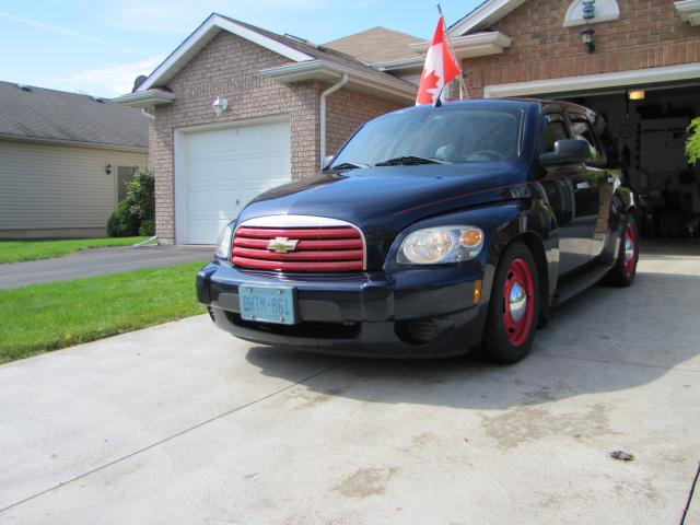

Old Apr 19, 2015 | 05:17 PM
Posts: 40,069
I stripped the chrome off because the chips and divots were right thru to the plastic!
You can sand prime and paint the grille.
I sanded the plastic primed it with high solids and sanded smooth, then color sprayed 4 light coats with 20 minute flash time between coats.
