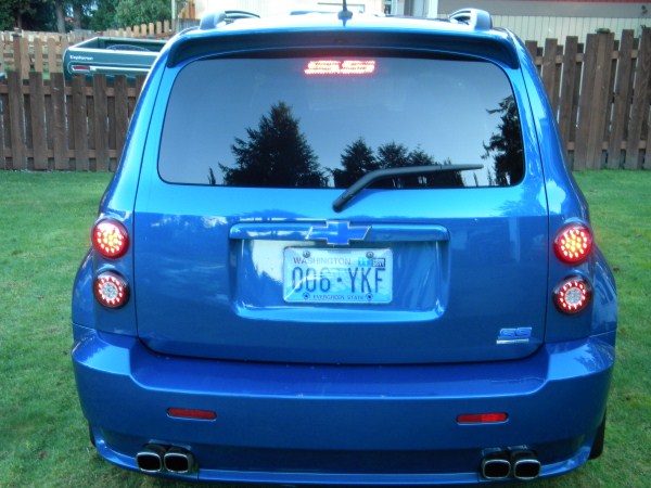

Just finished this sat,looks so much better. A few tips if you do it....make a stencil,big hole centered over small to create a donut for tracing purposes. Don't use a dremel! Much easier with a jigsaw. Remove all lights and use lots of masking tape. Also reverse and flip the tailights,and grind the 3 little tits on the housing so you can turn it for the best fit. I'm no bodyman and it took me an hour and a half. Would of gone smoother had I not wasted my time with the dremel...but worth the look. sorry didn't take pics...but you know what it looks like ..I hope

Finished mine a coupe of weeks ago. I used aviation snips to cut out most of the metal then used a steel grinding bit to finish it off. I didn't have a jig saw.
I like it. Put backup lights down in the reflector. Had one HHR owner pull up and asked me why all my brake lights worked in back.

Mine only took 15 minutes and 1 cold beverage.......

Those lights aren't cheap. Mine were $30.00 at a salvage yard.

Thought about the led's...just don't like the back up lights...wanted all 4 to brake and turn as well as 4 running lights. Tho I could buy 4 of the top led lights hmmmmmm...

So, uhhh... what are you doing for reverse lights?

I mounted my backup lights doown low in the reflectors.
