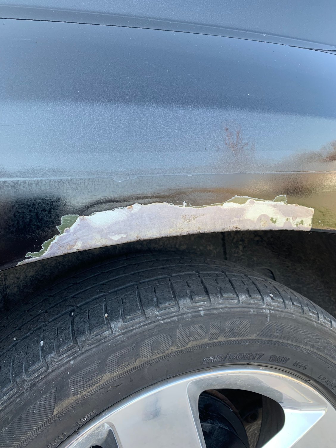

I get that the BlackSwan is 11 years old , but little rust bubbles over the right rear tire have shown up!

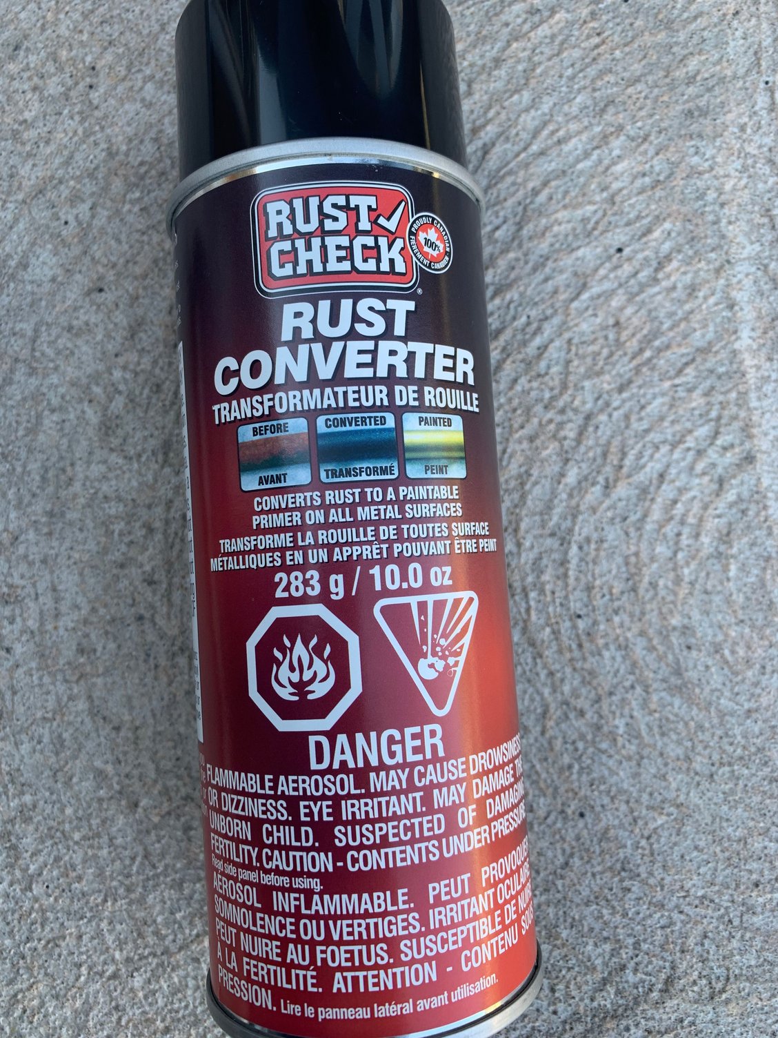

So, I cleaned off the loose paint and sprayed a rust converter in the bare metal, I will prime and colour coat it tomorrow, then clear coat it next week .
This is the product my body and paint guy recommended

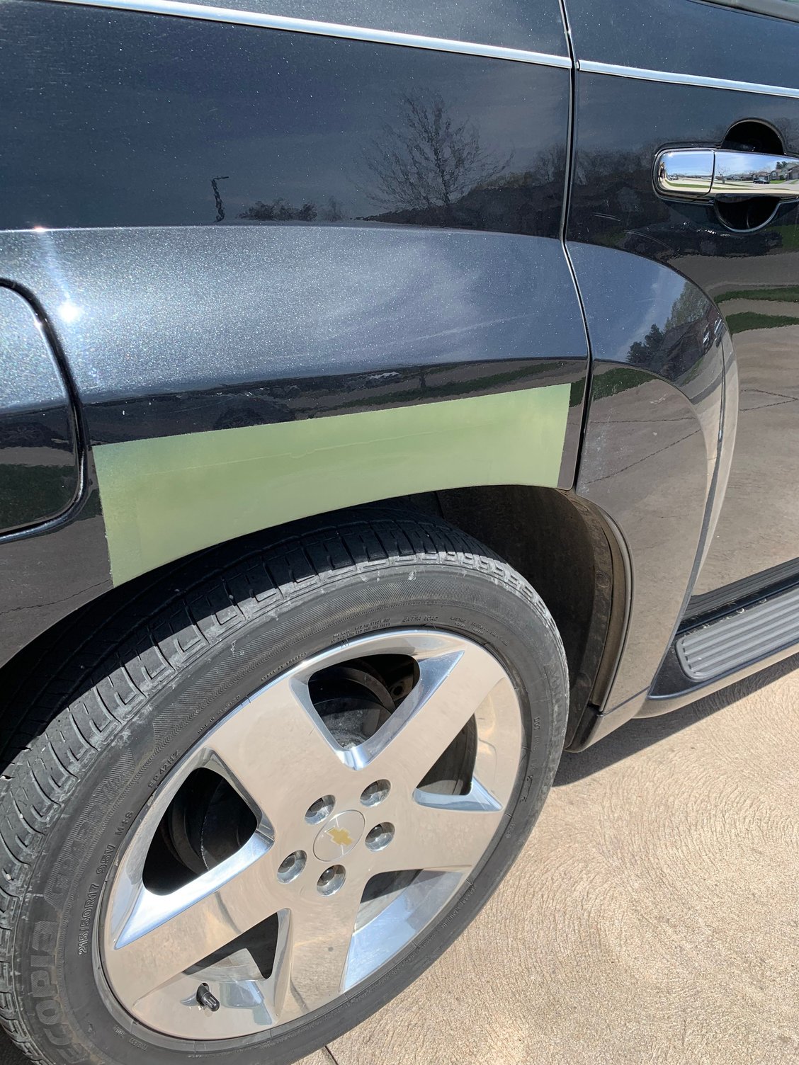

The sheet metal looks good no rust holes. Just loose bubbled paint. This is a photo after a coat of the rust converter

Been nice to have a before picture. Looks like you have paper towel plastered on it.
Old Apr 30, 2022 | 06:42 AM
Posts: 40,068
Closest before photo, the paper towel look is factory primer but mostly that is bare metal.

Oh, I get why the paint bubbled, somebody swung their door open and hit my rear fender! That loosened up the paint! I don’t know exactly when but I know it happened. As for a full repaint or tutone, not my style for this car.

Just finished masking off the respray area, I sanded with 800 wet, sprayed a polymer primer, I’ll let that dry over the next week, then spray the colour coat!
Old Apr 30, 2022 | 08:27 PM
I sanded with 800 wet, Man that's really fine grit for primer to bite into imo..
320 would have been my choice..
