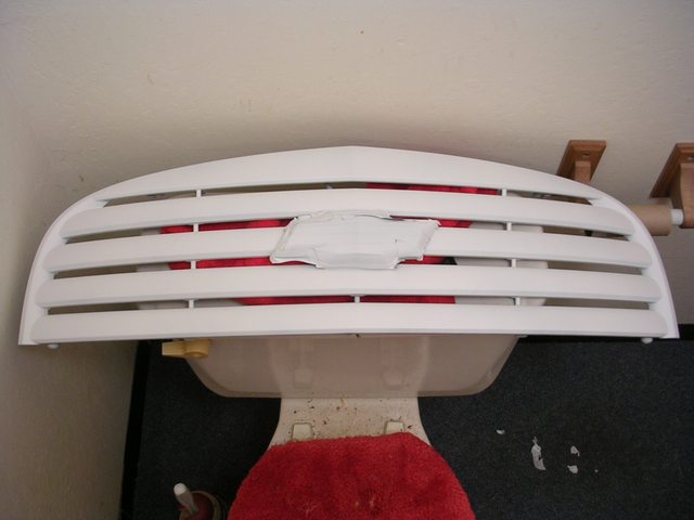

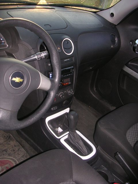

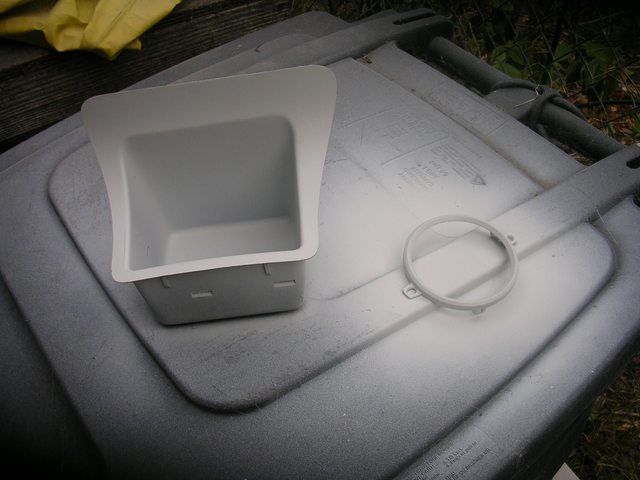

Originally Posted by tucsondivots
I have a chrome grill. From what I have read here, you are not able to paint over the chrome and have to peel the chrome off first? Also, do the after market grilles, such as shown in this thread, usually fit without much alteration? Thanks.
That is incorrect! Whoever gave you this info was not speaking from experience.
I have painted over my factory grill and hub caps.
You just get some 409 or degreaser, and make sure they are completely clean. (You will need to get into every crevice so this is the annoying part)
MAYBE get some very fine grit sand paper. I forgot if I used sandpaper or not but if I did, it would have been 2000-4000 grit (I can't remember if they even make 4000 - sorry, it's been a while)
Then get some plastic primer (I used krylon)
Let it dry for a week or more (the more the better - which is hard, since you probably need to drive your car - however, if you can avoid the freeway and want to risk a small rock getting thrown in the radiator grille, you can drive around without the grill on (I did, had no problems around town)
After that, I used gloss enamel (it has the gloss/clear coat built in it, so no need for clear coat for that nice shine)
I also painted my wheels with pink fluorescent marking paint, THEN after it faded, I did a little sanding and then the white gloss enamel. (primer, pink fluorescent, sanding, gloss enamel)
So far, after a year or more, the hub caps still look great. The only parts that are chipping are the insides there the bolts go (I did not think to really get in there good). Same for my front grille with plastic chrome paint. Although I did notice one chip, which cause caused by a rock making an indent in the grill itself)
I messed up the second coat of gloss enamel - it was 50f out and I did not wait till it was warmer to do the second coat - so it did the orange peel effect. You don't notice it unless you are up close, and I'm not concerned with looks too much, so I left it. I will fix it when I notice it has faded drastically (it already has noticeable fading, so likely soon - possibly with matching factory paint if it's cheap enough)
I have also painted the rings around the vents, trim ring around the shifter knob, and the plastic insert that holds the rubber thing (in front of the shifter knob)
I plan to paint the little strip on the doors, the grey pieces on the steering wheel, and the plastic chrome painted door handles. My exterior is white, and most of the interior is black, so I am doing a black and white theme.
I can gladly take DIY pics/videos of the whole process, since I wanted to fix the paint on the grille anyway. It's very easy and I have never really painted much in my life.
