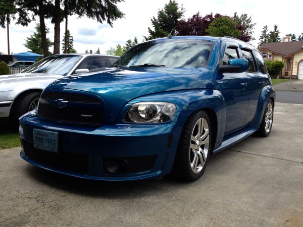

Except me I like to keep the color from being interrupted by the window seal, like this.

All the above is a mute point if you have the kind that mount on the outer side of the door.(like SS fans in the above picture)
