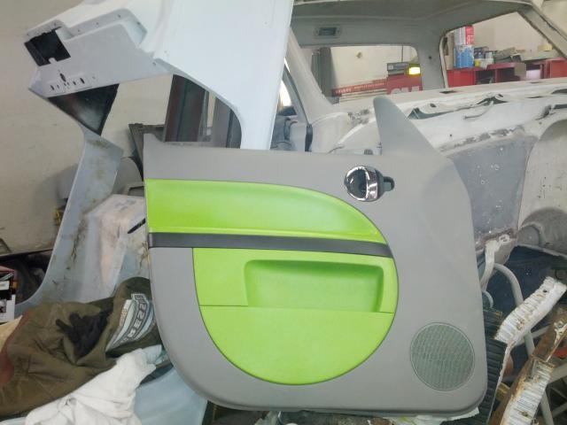

Door Pads
new door pads

how did you do this? Is it a dye or is a vinyl wrapped?

Paint I have a friend that works for PPG and got some super adhesion promoter that GM uses on there plastic and vinyl. Done it before works great also some flex agent in the clear with some mat agent in it

Very cool...odd color but cool none-the-less.

The PPG store sells adhesion promotor called "Bulldog", You must wear a resperator because that stuff is rancid!! I painted the whole interior of my 97' Firebird, and that stuff makes paint stick to anything!!

Did you take the panel apart or tape it? I just replaced a door panel and was thinking of experimenting with the broken one.

Taped it

What will the green match with?
