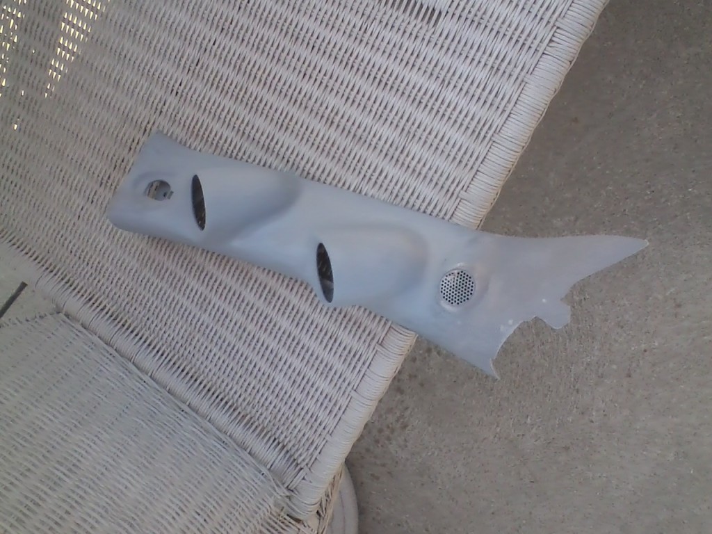

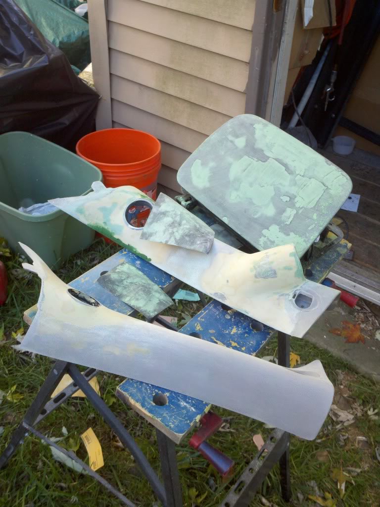

I made a single for the A pillar

I could have lined the whole thing. I used exhaust pipe as the shell, then glassed it in. I did destroy one cover figuring out the best way to do it. I heated the pipe with a torch, then pressed it into the cover. That method worked better than trying to cut and fit.
