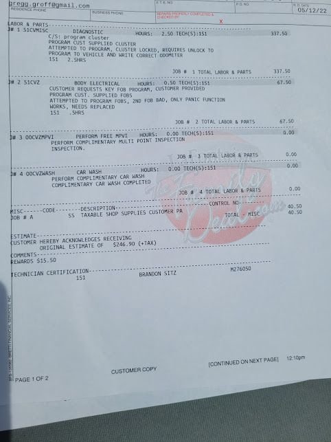

Just returned from the dealer, the operation was unsuccessful.
Now, mind you, when I made the service appointment, I understood that there was a good chance it wouldn't work, but I wanted a definitive answer.
A few attempts were made, and the technician came to the conclusion that the SS cluster was locked and would need to be sent out to be unlocked. This would be a minimum of another $100.00
My opinion, based on programming industial controls and HMIs is that GM made the SS panel incompatible with a non-SS BCM in order to discourage 'cloning' of a higher end vehicle. It's fairly common in industrial controls. Allen Bradley makes it impossible to use premium features in their hardware if you do not purchase the premium software to unlock them.
All told, this set me back $337.50 to find out it cannot be done. Am I angry? No. I was seeking knowledge, and that doesn't always come cheap or free. But now there is an answer to swapping an SS panel into a LT so anyone else looking to do so now knows GM made it extremely unlikely that it can be done.
This leaves chip swapping. I am not certain if I am going to attempt that, but who knows? Once I get my full workshop set up in my new garage I may take a stab at it.
I also tried getting a cheap Amazon keyfob programmed on this trip, I'll make a thread about that so it is searchable.

So they quoted you $275, then charged you $337.50, then asked for more?
Old May 12, 2022 | 01:35 PM
Posts: 26,522
I call BS. "Uninformed" technician. Much like the one that told me there was no RCDLR in my 2008 or the one that could not find the SDM in my 2011 and had to call Techline to program it, after I pointed to it for him.
