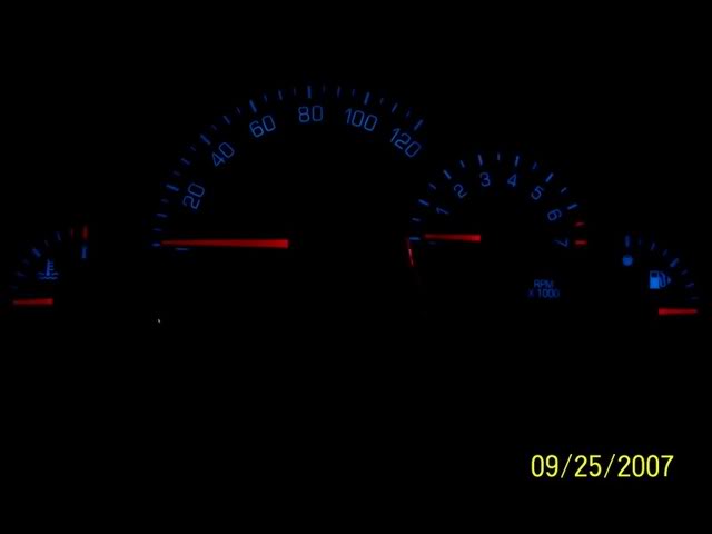

Originally Posted by crowbar
is it the same size led bulb that goes in the hole that lights up the window switch?
window switch?
Redone with red needles....
