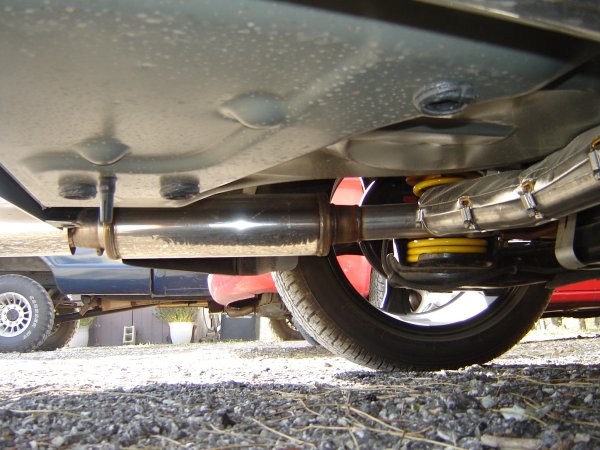

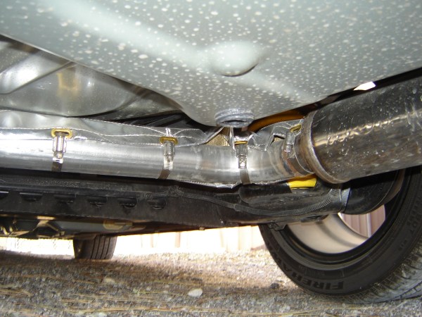

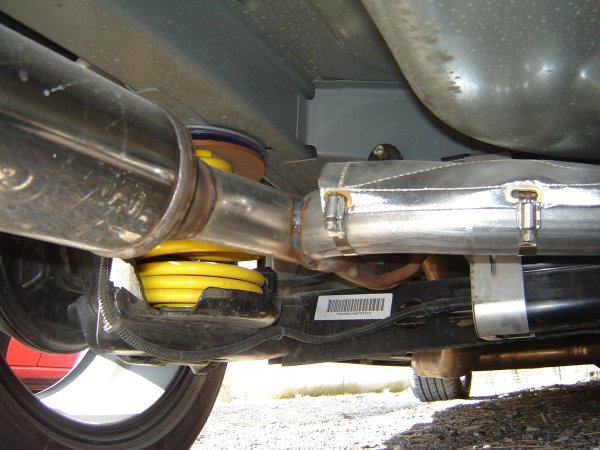

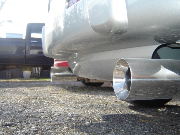

Finally took some pictures. I'm not trying to brag here, but looking at other pictures of dual exhaust HHR's (with rear exits), I think mine looks the smoothest. I was really happy with the work they did.
I put a heat shield on afterwards, just to be safe. (It's supposed to be loose like that)

did you use the stock pipe from the cat or make a new one? looks nice also what did you use to cut out the rear for the pipe exit

The stock pipe was used. The new pipe starts right before the Y.
You can use about anything to cut out the rough shape. After that I used an electric drill with a cone shaped metal die grinder attachment with cutting edges (not sure what it's called) to smooth it out a bit, then used a grinding stone attachment to finish it. There are probably better tools to use, but they worked for me. I'd still like to change the shape of the hole I cut, it looks like it might be a little off. It's hard to tell though because on the drivers side the bumper goes in a half inch or so and the other side is smooth.
