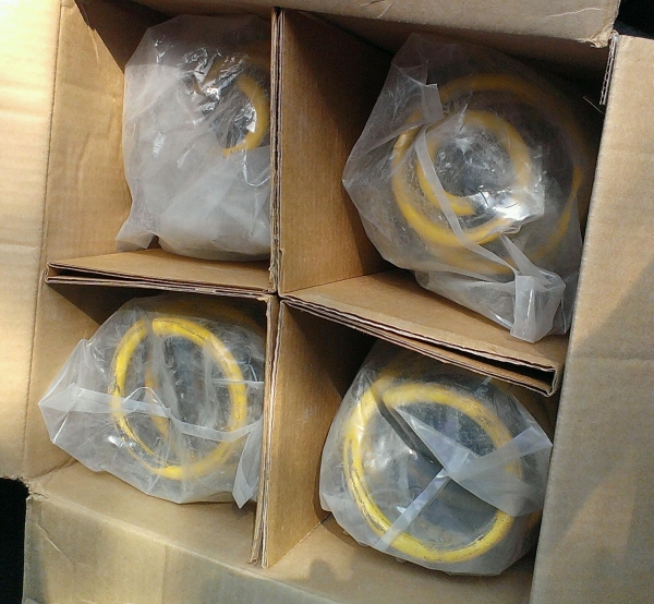

I finally got around to some suspension mods. Recently got a good deal on some 2nd Gen. Goldlines, and an even better deal on some used SS shocks & struts that I got for free months ago, both from fellow members.

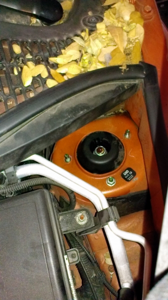

My suspension was completely stock FE1, with OE shocks & struts. The ride was way too soft, felt like I was floating. I also felt "disconnected" from the road, so needless to say...this had to change. After a quick trip to AutoZone to buy stuff for a future mod, I dove right in.
This was a one man job, with no impact tools available...so it took me a little longer than most, but it was so simple. Overall, probably about 3 hours including the daunting task of hand wrenching the spring compressors (multiple times for the first one). Due to this, I tackled the fronts first since the rear is literally a 20 min job, involving 6 nuts/bolts in total.
The first & best piece of advice I can give for this job, is to break torque on your strut retaining nuts before you remove them from the HHR, if you do not have impact tools!! This saved me from lots of additional sweating & heavy cursing.
(Oh, and pay no mind to all the autumn foliage...it's my Fall Harvest Edition!

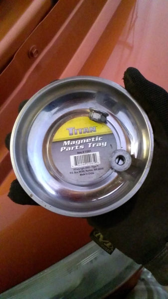

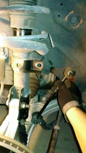

Something else that is quite useful... Without it, I chase nuts like squirrels...so it's a must have in my book.

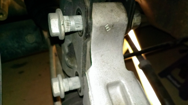

Just a few quick nuts to remove, but leave the two on the strut slightly threaded, so you can hammer the bolts out with no damage to the threads.

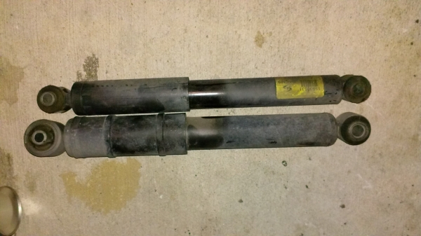

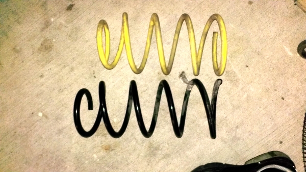

There is quite a bit of difference between components, which I hope translates into sufficient drop to satisfy my desire. I'm sure it will be a vast improvement over stock.

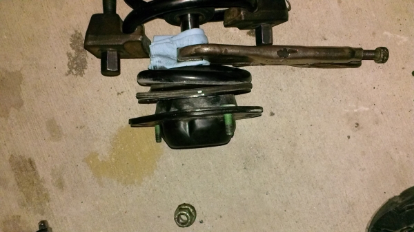

I used a folded up shop towel under vice grips to get a good grip on the center shaft and remove the retaining nut. Again, if you do not have an impact gun, you can break torque on these while still installed in your HHR. Another good trick is to keep a bit of an old belt handy. The rubber will both grip the strut shaft and also prevent bite marks from the vice grips.
So after disassembly, cut your bumpstops...and reinstall in the reverse order. Unfortunately, I didn't get any photos after reassembly...but it looks the same, just yellow springs. No pics from the rear install either...I was being rushed by the gf to finish and get cleaned up since we had plans that night. But, as previously mentioned...it was as simple as removing two bolts and one nut from each side. I'll try to at least get a photo of the finished rear.

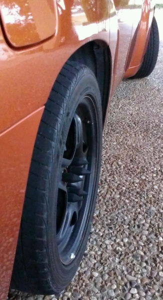

I've also been waiting until it was dropped to add my lug spikes, so voila! There they are...

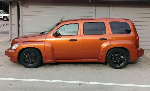

Immediately afterwards, I rolled her out of the garage with her new stance and went out for some late night shenanigans. First impression...WOW. What a monstrous difference! Of course the low, aggressive look is fully achieved, but I was supremely impressed by her new handling characteristics and complete lack of body roll. Oh how I love it!! Even the gf commented on the incredible difference!
Yesterday was completely a lazy recovery day...but I still found an excuse to go for a drive and snap some pics.

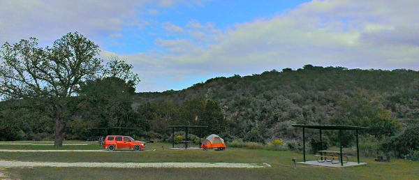

Our campsite was pretty solitary, only one other tent in the area.
Decent tent site...nice & spacious for sure.

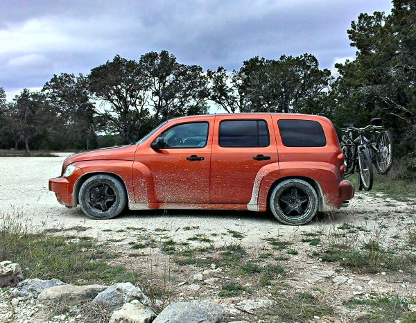

The road in & out of the state park was around 15 miles of dusty gravel. A few large puddles here & there, and thus it began...my dirty girl.

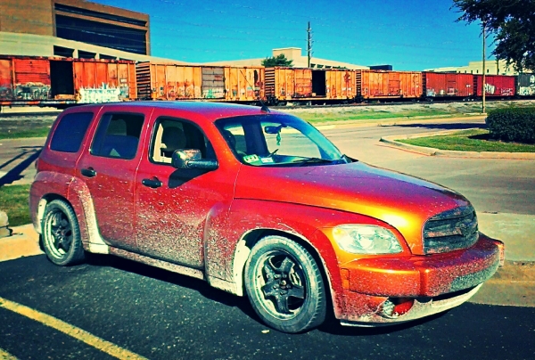

This was as dirty as I could get her by the time we got back to Dallas. I love this picture with the rusty tagged railcars in the background.

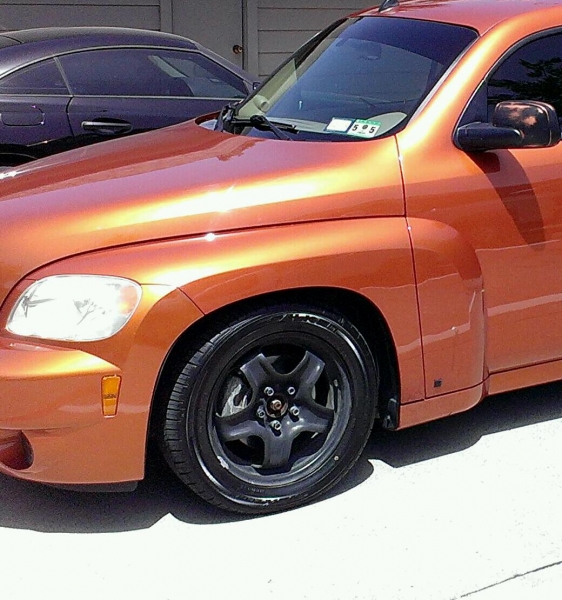

After 7 years & approximately 65k miles I figured the stock front tires were long overdue. Replaced them with a set of Falken Ziex 612's. Seem to be pretty good so far...time will tell.
