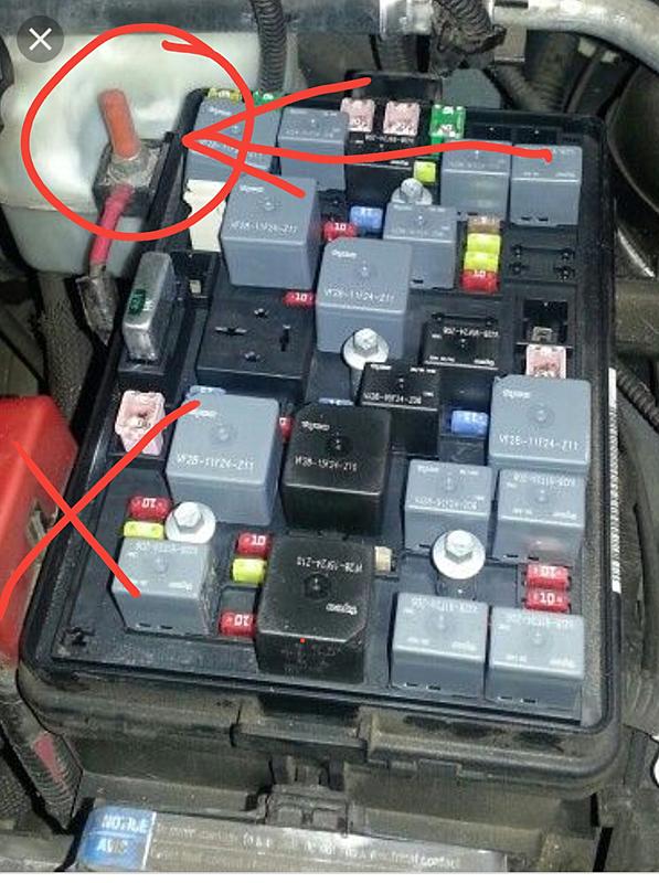

I'm going to attempt to upload a picture (hope it works) but this "post/terminal" is corroded (green colored nasty looking) and then there is a reddish/orange, plastic/rubber like piece that sits over the post/terminal
***it is NOT the post/terminal that is covered by the RED "(+)" symbled cover!***
⚠️also, this picture is not of mine, it is one from google!
That corroded terminal that you are talking about, needs to be cleaned up to remove the corrosion etc.. That dirty terminal will affect a number of your current issues (steering, starting).
Working with the electrical system can be hazardous, and can cause damage to other components in the electrical system of the car. Before attempting to clean that terminal, one needs to remove the NEGATIVE (-) cable at the battery in the trunk. Do not attempt to remove the Positive cable at the battery, as if the wrench is shorted out to the body of the car, it can cause a short which can cause the wrench to go red-hot and possibly cause the battery to explode.
Don't forget to lay a towel over the rear hatch locking mechanism, or leave the hatch open while the Negative post is disconnected, as the hatch cannot be opened easily with the battery disconnected.

The one circled is the power steering. The one with the X is the positive jump point/battery. BTW: that is all in your Owner Manual, see link in my sig.
First try tightening the 4 bolts on the fuse box.
