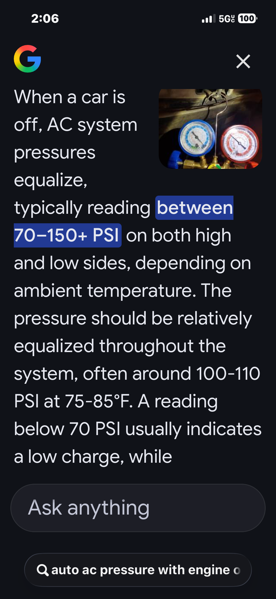

Old Mar 25, 2026 | 02:28 PM
  #30
Posts: 11,721
For reference since you said your pressure was 24 with the compressor off.
https://www.chevyhhr.net/forums/atta...1&d=1774466804
