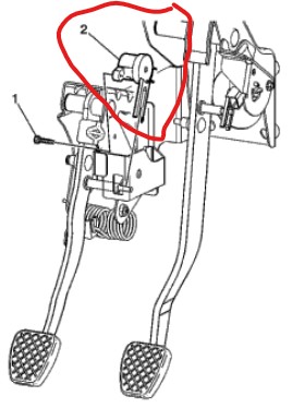

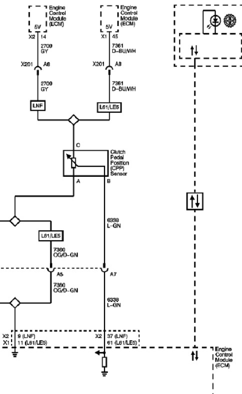

A stick shift has an interlock switch on the clutch pedal instead of the park/neutral switch. It won't crank or start unless that switch is engaged. Really it is a "pedal position sensor" that sends a signal to the ECM, it also turns the cruise control off.
Are you sure that you replaced the ignition switch and lock with the recall parts (not off the shelf replacement parts)?
