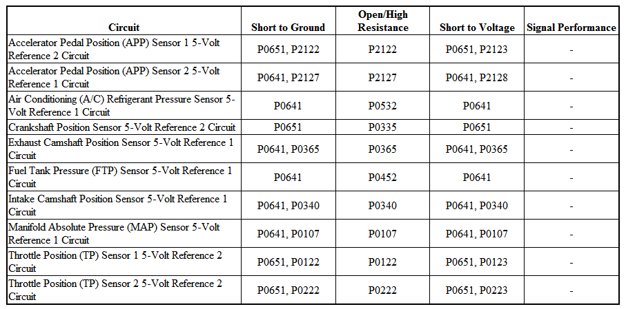

What came back? Just the P0641?
Check everything that says "reference 1 circuit", for connection and frayed wires and shorts etc.
Concentrate on the wires to the MAP sensor, not the MAF sensor.
