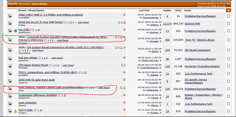

I have researched, that's what brought me to these forums, the problem is, I'm not seeing anyone mention p0014 with harsh shifting.
That's hard to believe!
Type "hard shifting" into the search box, or many other variation. That is one of the most posted problems.
I'm not saying it will definitely cure the problem, but most likely. The code DOES NOT indicate bad sensor. It cites a mismatch between the sensor and the valve, sensors rarely go bad valves frequently go bad :QED.
Put "P0014" into Google to find much more about it.
