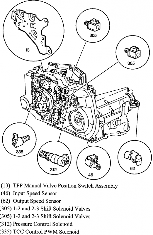

I didn't notice you were in CA.
Those 2 codes indicate that the wire from the bottom of the trans to the TCM is compromised.
Number 62 in this drawing.
Attached Thumbnails 2006 HHR LT Gremlins - Speedometer/Powersteering/check engine/bad shifts 2nd and 3rd-traspeed.png

I posted the pic while you were typing.
Check your PM.
