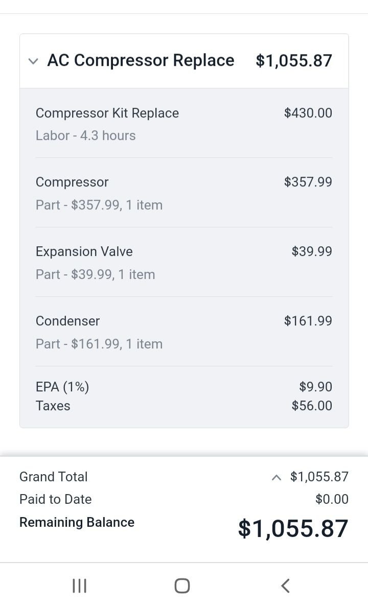

Ok guys...I'm not about to spend over 1k having a new compressor put in my car. Though these insanely hot weeks are getting to be too much...I just can't do it. Especially since I just had to upgrade my house's electrical for about the same amount to avoid a house fire! 🔥 @firemangeorge wouldn't make it here to save my house!
So have any of y'all installed a new compressor...if so how difficult would you say it was?

$1000.00 WOW!
Brand new they are around $200.
There is one bolt connecting the hose assembly to the compressor,
and two bolts connecting it to the block.
Evacuation and recharging the system shouldn't cost over another $200.
Space is tight but can be done with the car on jackstands.
That's how I did mine.

He said he can't warranty it without replacing all of this...
Well my parts have a warranty if I buy them myself. Will I need an expansion valve? The compressor is fine. I just need to put a RockAuto order together.

That bill is a bunch of B.S.
Why the expansion valve and condensor.
NEW compressors are less than $200.00 so to charge $358 is a ripoff.
NEW condensors are under $75.00.
NEW expansion valves are less than $25.00.
I would seek another opinion and look elsewhere for the service.
