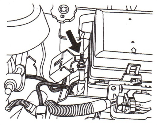

Old Oct 9, 2014 | 10:48 PM
Lucky's Avatar
Joined: 12-24-2007
Posts: 2,873
From: Seville. OH
Check and make sure this cable under the hood is tight. They are known to come loose and can cause a no start.

Old Oct 14, 2014 | 12:09 AM
keyara's Avatar
Joined: 10-14-2014
Posts: 1
From: VA
Having similar issues with my 2008 HHR. Wont start and wont jump but lights/radio etc all working. Not sure if it's the security system or this cable is loose? How would I tighten it?
