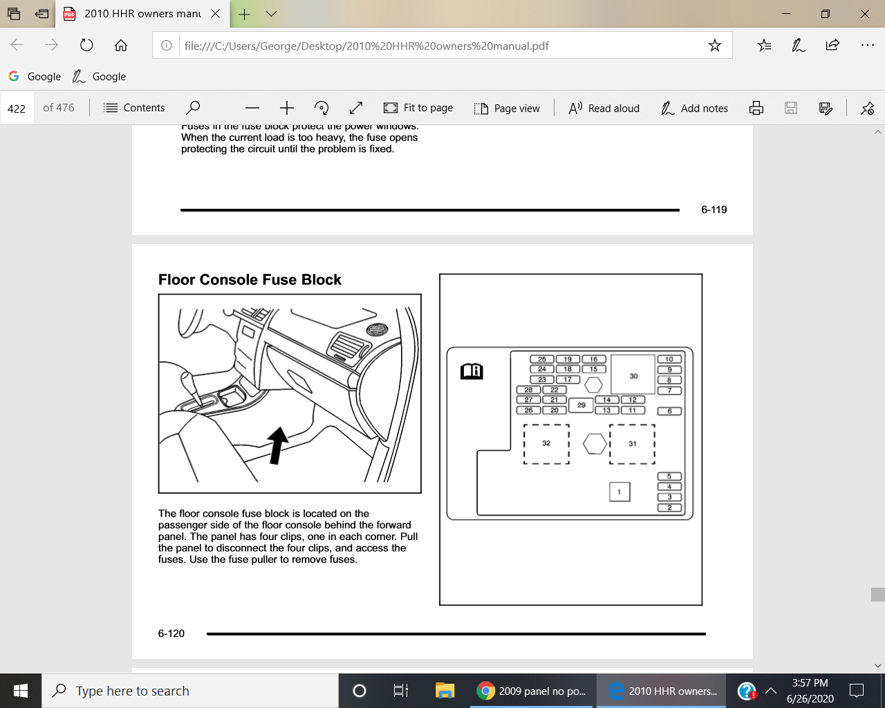

On the Body Control Mod.
Big 30amp pink one?
Not sure yet which relay is #32
Thanks, working on it.
Old Jun 26, 2020 | 04:05 PM
Posts: 11,721
The RAP relay #32 is not visible when you look at the floor console fuse box. Weird but it is apparently located on the backside of the fuse box. I don't think you can access it without pulling the fuse box (BCM).
The dotted lines in the diagram are to show you it's not visible from the front view.
