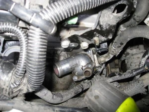

Hey Guys, I have a Slow coolant leak dripping from underneath, looks like its dripping off the trans pan.
Happens after its driven and parked, and later there's a wet area under the car.
I can see from above what looks like some dried coolant leak spots near the back of the cylinder head
by the heater hoses on the drivers side. Anyway, thanks for the help.

Welcome to the site, could be a loose heater hose clamp and the rad hose goes back to that area

Look at the plug on the t-stat housing, they tend to get pin holes in them with age.

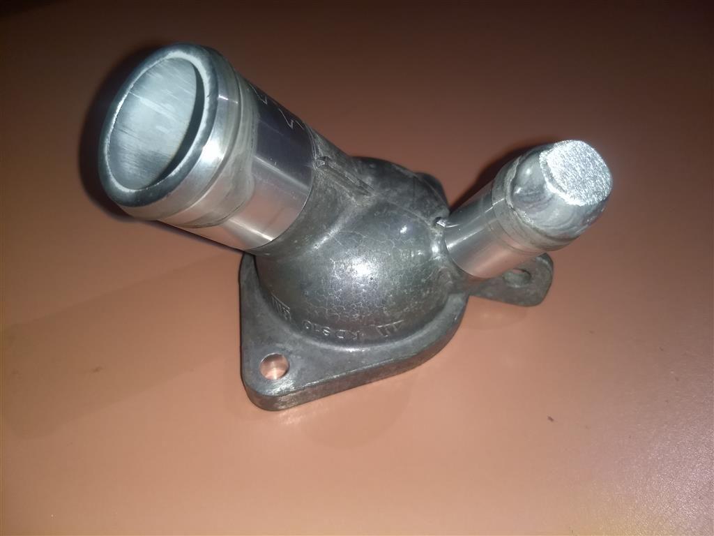

I’ve found the plug PN 15544596 to replace the leaker, at RockAuto a package of 5

Is there a thermastat housing that does not have that hose nipple sticking out of it?
I'm just curious why its even there if its not used?
