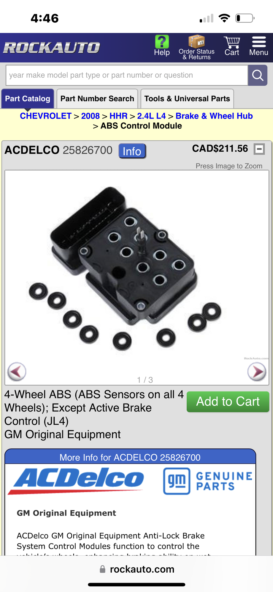

I have a 2008 LT and the ABS module has been out for some time. It's discontinued, so I can't find one but other than dash indicators being lit it hadn't been a problem. Recently, a whole bunch of other things started going wrong - very hard shifting, gauges going crazy, alarm(?) dash indicator on, and battery (new) needing jumped every time I turn the car off. I took it to a dealership who said it was the ABS module. I'm not sure that the ABS module could cause all these problems. The car will drive perfectly normally for about 10 minutes and then it gets worse and worse. When I drove it off the dealership for storage, the power steering had gone out by the time I parked it. Does anyone have any ideas? If the module is the problem and I can't get it, is it feasible to upgrade the system to accommodate a later model's module?

maybe GM has discontinued it but RockAuto lists the ABS module

Thanks, I'll see if I can do that, but it's just been at the dealership and the battery is only a couple of months old. The ABS module for this model is the AC Delco 25798970 which also has active brake control. The ones I can find do not.

https://www.rockauto.com/en/parts/ac...ol+module,1844
Click on notification when back in stock
