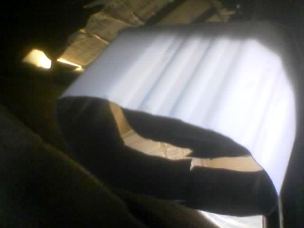

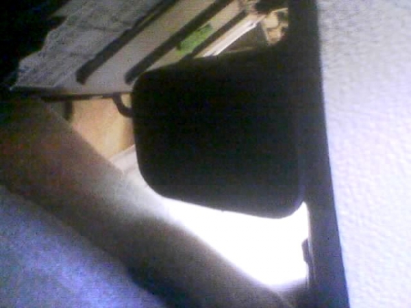

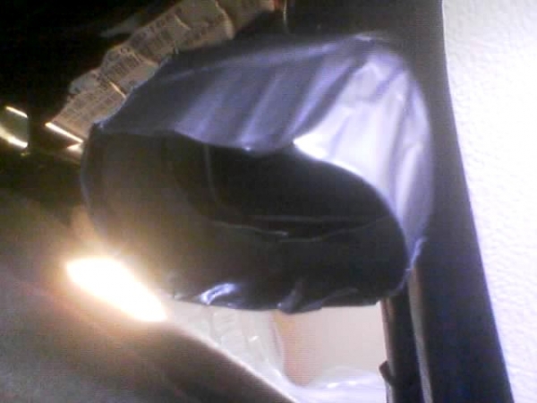

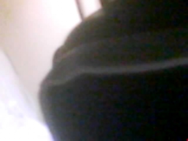

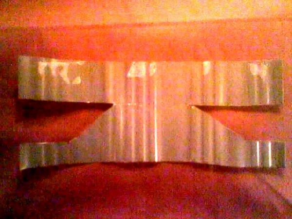

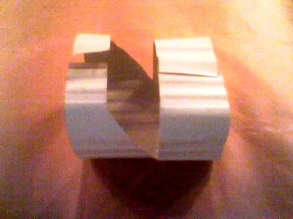

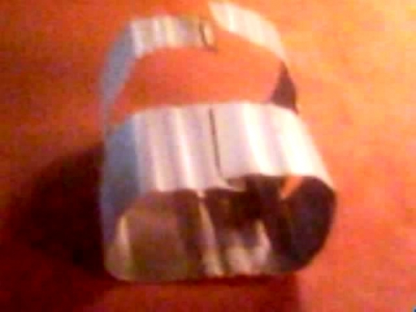

Sorry the pictures are so crappy, they were done on a cell phone. Here's what I did...
Tools:
Piece of paper 6" square
Pen or pencil
Good pair of scissors to cut aluminum
Supplies:
Aluminum downspout (approx. 4" long)
Double faced tape (I used Duck brand that is about 1/16" thick and spongy.
Duct tape
1. Press a piece of note paper on the end of the duct to get an impression so you know how big you need to make the adapter.
2. Mark impression with a pencil or pen to see it easier.
3. Measure the perimeter. Add at least 1/2" for overlap.
4. Cut about 4" of downspout and flatten. Cut long side to length from step 3.
5. Cut cutouts as shown in picture. The angle cut ends at about where the bottom corner is. The angle you cut will determine the angle you bend it to. Mine is about 45 deg. and my right foot gets a little hotter than my left. So a little less would probably be better (maybe 30 deg.?)
6. Bend the sides so it looks about like the sketch from step 2.
7. Bend the angled side down and wrap the flaps around to match the edges from step 6.
8. Test fit and adjust to fit the duct. A little loose is ok because the double faced tape will hold it in place.
9. Remove aluminum pc. and wrap double faced tape around edge of duct.
10. Re-install aluminum pc. and form fit starting at top center and working your way around to the bottom in both directions.
11. Adjust downward angle and form fit to close the gaps as much as possible.
12. Use the duct tape to seal all seams. (Just duct tape it all.)
I used the downspout because I had a piece laying around. You can probably use anything that will hold a shape and be easy to work.
Any questions ... just ask...
George

Now that we have much colder weather, I have a fair assessment of the mod. This car heats up great... It was 9 deg. this morning coming in to work. I had enough heat in about 10 min. to start turning down the blower where before I would have been fine from the waist up and had cold feet.
