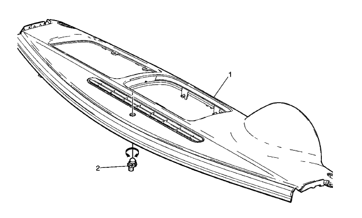

Old May 23, 2018 | 07:32 PM
Posts: 26,532
Since it is the ambient light sensor that controls the dash lights, my first guess is the sensor wore out. Did anything happen just before this behavior?
