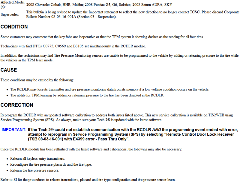

And to add this. Regarding the key fob programming issue. There was a problem on some 2008's . Something to do with the RCDLR losing it's memory or something.
Donbrew our Tech Moderator should be able to pull up that info for you.
Old Aug 1, 2017 | 02:35 PM
Posts: 26,539
Yeah if the 2008 lost power for an extended period the RCDLR needs to be re flashed with updated firmware.

Seems like Donbrew's suggestion of the system needs a reflash of firmware
