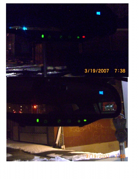

A little background to my ongoing battery problem. The first time my battery died was on Christmas. The prior evening, I noticed that the OnStar light was red, and not the usual green. According to the OnStar people, this indicates a problem. Tonight, I went to use my car and the battery was dead. (I used it all day yesterday without any problems, and according to my tester, it was fully charged last night). After charging the battery for about 10 minutes, it fired right up-but the OnStar light was red again.
[IMG][/IMG]
I called them from the car, and they said everything checked out OK. It could be reading an electrical problem, or it could be transmitting and killing the battery itself. I have been sick with the flu last night and all day, so I could not bring the car in yet. SO now I still dont know if it is a bad cell in the battery or a problem with OnStar. But checking an intermittant problem is always tough. How could they tell if OnStar keeps switching on and draining the battery? Unless there is a record of calls made?

Since the battery behaves one day, then not the next, I'd suspect you have an intermittent draw on the system, someplace. If the battery were bad, it would be bad all the time.

I took the car back to the dealer yesterday, and they checked the battery again and it tested ok. Next they did their own leakage test and found 2600 mA (I guess I am not good with that scale on my multimeter). They traced a large drain to the BCM circuit. So, now they want to give me a loaner car and check everything that fuse covers, including door locks, grounds, etc.
I am a little nervous because while a was able to pull the 4 fuses that cover everything that I installed (horn, GPS, map light, stereo, etc) I still have one item connected to the radio harness-the Metra adapter. If that is the cause of my problems, and the dealer picks up on it, I will be resonsible for all of the labor and repair charges. So I have to remove it first before bringing the car back
