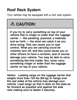

No preclusion. I think I'm being lied to. I'm taking it to another dealer. It also is having hail damage repair done this week. Do you know how much weight can go on top?
Old Jul 19, 2007 | 01:27 AM
Not sure about exact number, but not much. Maybe 100 pounds?
Old Jul 19, 2007 | 01:35 AM
Page 2-46 of the 2006 manual...............150 pounds

Do you have the rack SYSTEM required to put weight on the roof?
Not just the roof rails.
If so, it should clarify weight restrictions/limit.

Thanks for the info. I do not have the rack system. Just the rails. I didn't know if a small,soft vinyl carrier with beach towels and blankets could be out on top. Going to the beach! I am going to have them just replace the brakes no matter if they are covered. There is only 25,000 mi on the car, but the squeal is getting to me! Thanks!
