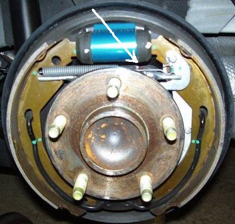

I haven't messed with the rear yet. But I think it time to make sure they are adjusted properly (55K miles). Just haven't looked to the adjuster yet. Those that have, where is it on the rear drums?
solman-
Rear brake adjuster is on top towards REAR of car (see arrow in pic), there is a rubber plug in backing plate to access it (on mine anyhow)... Not exactly easy to get at, but a couple clicks a big difference..
I just removed my drums to clean. inspect & adjust & finally paint them..
