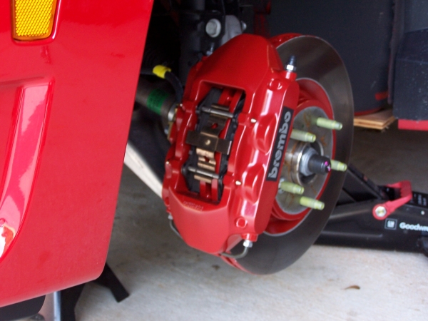

Whichever ones you get, just remember to spiff them up before installing.

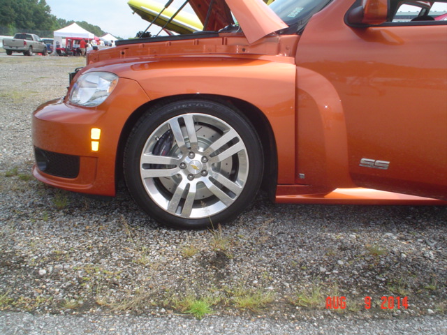

I've been happy with the 14.5's

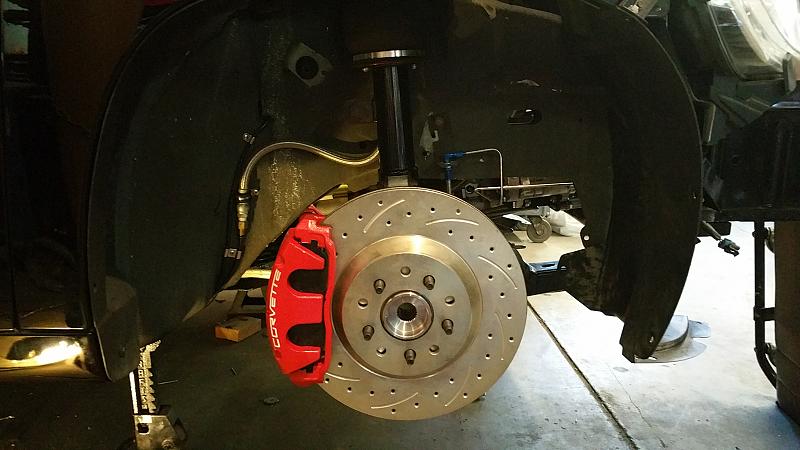

You could also try the Corvette C5 setup.
Old Dec 7, 2015 | 07:34 PM
87z16's Avatar
Joined: 09-04-2012
Posts: 170
From: LI,NY
thats NICE lasater!!! how difficult was that swap? what else is needed???
Old Dec 7, 2015 | 07:41 PM
FireFighterHHRSS's Avatar
Joined: 05-23-2015
Posts: 9
From: Cleveland
^^^+1
Old Dec 7, 2015 | 10:31 PM
lasater's Avatar
Joined: 04-06-2010
Posts: 655
From: Riverside, California
The swap isn't too bad if you have a bunch of tools at your disposal.
Let me first say that this didn't go on a stock HHR. It is using a Hydro Boost system from an Astro Van mated up to a Corvette master cylinder. The stainless brake lines are not stock and the lines go thru a B&M line-lock system. The spindles have been reversed from right to left but that won't effect the braking. The brackets and spacers are made of 3/8" & 3/16" plate. The rotors are C4 Corvette and the calipers are C5. Of course the rotors need to be re-drilled to 5x110 mm. The concentric ring is machined out of 3/16" plate. I'm not sure if it will need a proportining valve or not as I haven't used the system yet.
