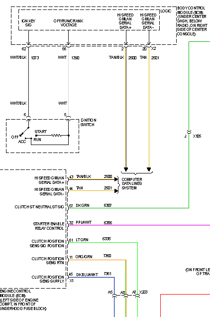

An experiment to see if the TDM is doing it:
turn the key to run
start engine by jumping the relay
if it runs the TDM is reading the key and sending the fuel continue signal.
Another 3:30 AM thought is the switch itself may be bad. It is one wire the start position sends a 5V signal via a 1.8K resister,
Earlier I said it is the BCM that sends the start signal, that is incorrect it is the ECM. Which adds another thought; lately there have been reports of oil migrating up the wire harness to the ECM and fouling the connections.
Here is the pertinent part of the wiring diagram. The purplewhite wire carries the start signal to the relay, the dark green wire is from the park/neutral sensor. on start the white black should be less than 5V , in ACC or run it should be 5V.
