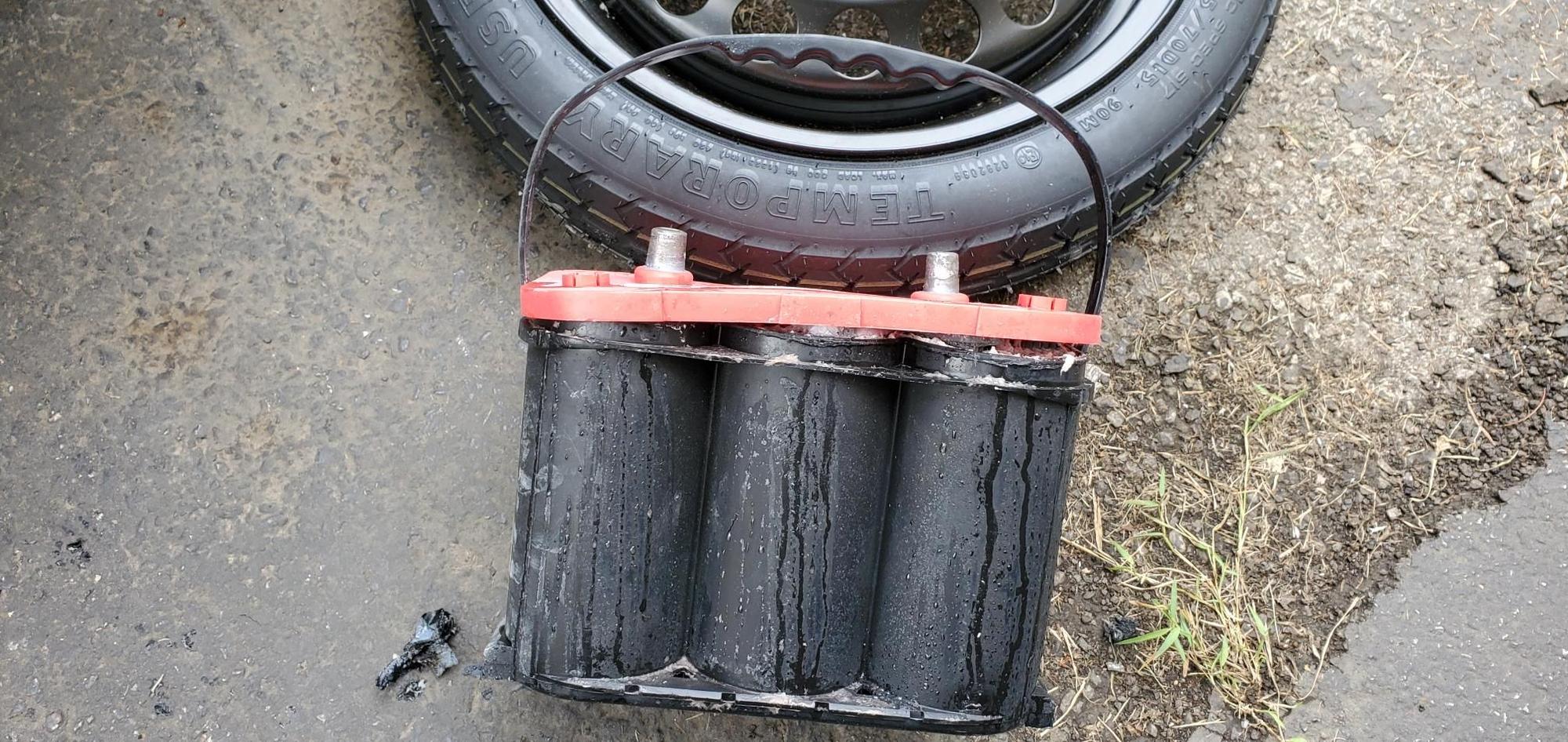

We
Well... that was an easy (and relatively inexpensive) problem solver. I couldn't see the battery well..uh, well since it's cloudy here this morning after the rains. My Optima charger had stopped, saying the battery couldn't be charged. Huh... loosen everything, take the battery out and oh.. wow. Yeah, that would do it. I guess it didn't like sitting for all that time without even a trickle charge on it. I guess that's also what I was smelling all day - good thing I had the windows down. So now, I have a spare "garage battery" installed, car is running, cleared and checked any codes (so far there are none).. I reckon I dodged a bullet there....

Welcome back, my first thoughts were …..dead battery, and you confirmed that! Better to spend money on a new battery then new cats!
