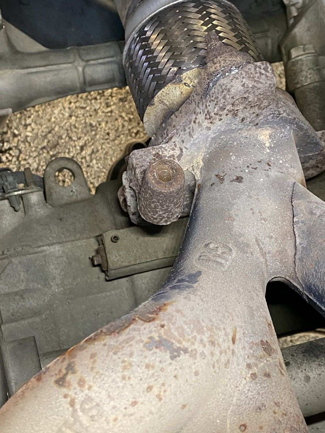

These 2 codes got me started on this car. When I started it up I could hear an exhaust leak and the inside of the car had a slight exhaust smell. Checked the exhaust system and it was a complete rusty disaster and there was a leak at that flex pipe. Took it to a muffler shop and had the entire exhaust system replaced. It's all nice and solid now but still getting these codes.

Cracked flex pipe.

That was replaced in post #1 Donbrew. I’m wondering if the catalytic converter was replaced or just welded to ?

That entire exhaust system was replaced and that included the cat-con. I don't hear or smell any leaks but will put it up on ramps and check under there.
