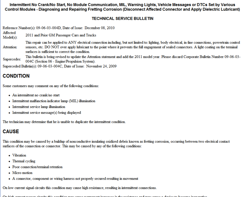

Old Aug 1, 2017 | 08:35 AM
Posts: 26,541
The vette is different from the HHR; I doubt that is the explanation. Unless, the faulty segment is on one side or the other of the BCM.
Look at this: https://www.chevyhhr.net/forums/hhr-...3-48534/page2/
Keep an eye on your PM.
There is a TSB with photos about the ECM connector, but I can't find it right now.
Here is part of another TSB:
