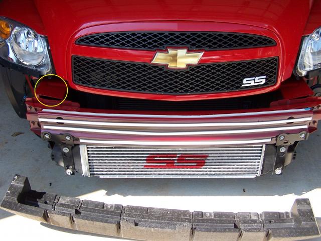

Since your's is a 2007, the temp sensor should be located in this place(yellow circle )
A little hard to get at since it's behind the bumper area.

Mine is a 2006 but I would think it would be in the same place. Do you happen to know what the sensor is called/ or looks like?

Ambient air temp sensor. Looks like a Xmas tree light covered in plastic.
