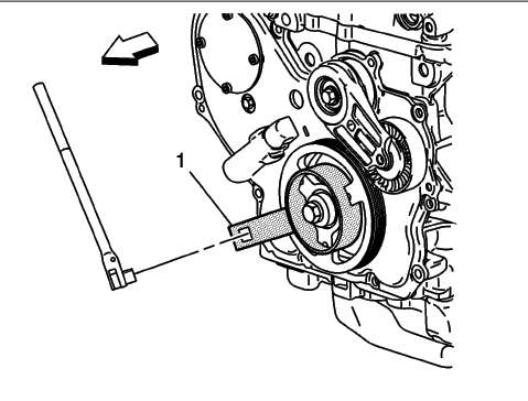

You will need a tool to hold the balancer to get it on/off.
Torque to 74 lb ft then 125 degrees.

Thanks donbrew,
I'll opt for the screwdriver or prybar wedgy situation and pin the pulley as numbnutz did in the video... 👍
