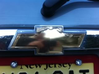

Is there an easy fix for the bowtie when it looks like this? (my back hatch door) Or do I need to replace it with a new one?

Had this happen to mine in back, water just gets in there. Best bet, pop it off with a putty knife, clean it with a 3m pad. Paint it and reapply with marine silicone.

That is meant to go on the front of the bowtie, and after about a year of washing and weather, your no better off. Krylon makes a great plastic paint, just again clean with a good degreaser and a 3m pad and apply paint will last much longer. I originally went with a carbon fiber vinyl. It peeled and bubbled and color faded.

these are only held on by likke dubble sided tape kinda stuff?

its originally attached by double sided tape, you can either silicone it back on or use a heavy duty double sided tape again. Just make sure to clean up the backing so that there is no more of the old sticky stuff on it when you apply the new stuff. Best thing is to sand, prime and paint it, water and windshield washer fluid gets in it and it eats away at the gold leaf inside the emblem, if you replace it with a new emblem, it will just happen again, so just paint it! :)

ok cuz i have both the front and back one going

seems to be a trend, my front is starting to look this way the back one was replaced at dealer in 2009 still looks good, I'll be spraying them next spring

my front is bad too~ worse than the back actually. I am hoping to replace the grill at some point so Im not too concerned with my front.
