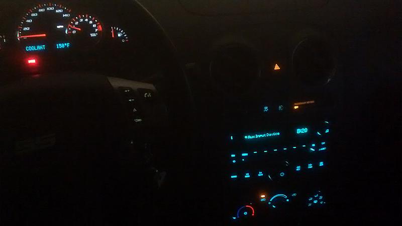

Hmmm... Just went out and started the car, in the dark, dimmer set to bright, but not dome lights on.
Attachment 20813

In your upper photo, this is what mine looks like at night for about 2 seconds, then everything goes out EXCEPT the back lights in the IP (upper left side of photo) and the radio display (aux input, clock) all the other go out.
Interesting that your IP lights went out when you put a bright light on the bubble, mine stay on all of the time, and will not change with the dimmer.
