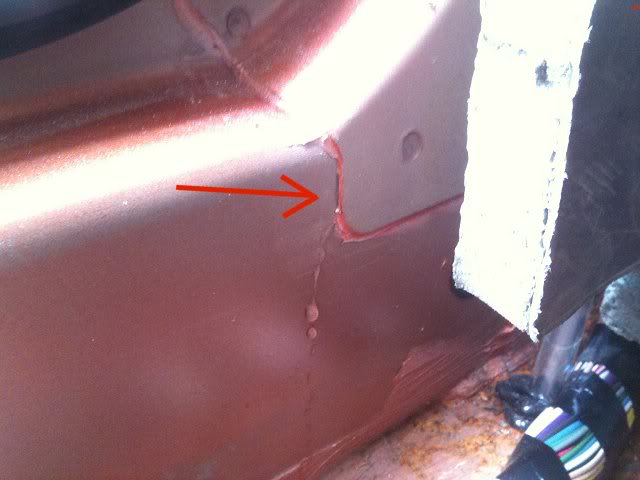

Hello stan,
I found my water leak last week on the drivers side froor. (it was soaked)
It was the seam near the hood release handle not properly sealed. Here is a pic with the water leaking when I hosed it down and the carpet pulled back.
Good luck!
Craig~
Old Apr 19, 2011 | 09:35 AM
prod's Avatar
Joined: 12-14-2007
Posts: 2,964
From: Toronto ON Canada
I dont think there should be water getting in that pillar in the first place, you should try and find where its going in.
