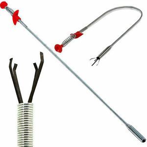

Hmm, a problem for sure, do you have a grab claw tool?
Like this four claw 24” flexible tool
If that does not work, then it’s time to put the manifold off.

I do not but I will go grab one of those and a pair of the bent angle needle nose. Hopefully I can fish this thing out. If the manifold needs to come off I may just have a shop do that.

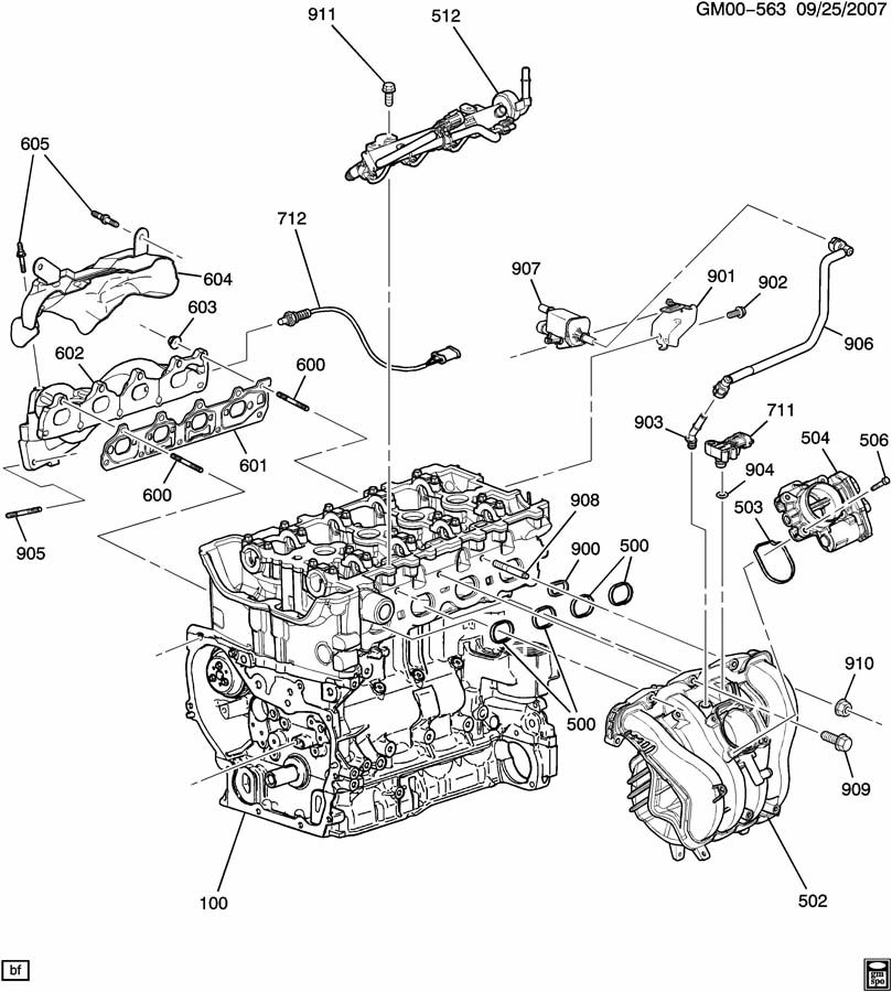

I’m not remembering a divider or separation piece, just an oring gasket.

All I see is the O-ring.
