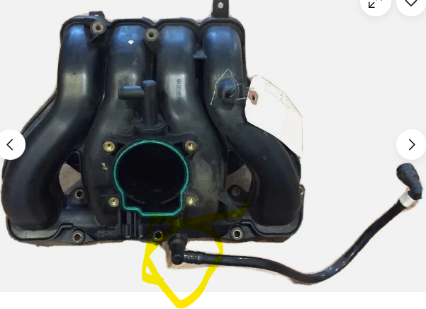

Update I found this hose laying towards the bottom of the radiator area I don't know where it connects to the motor at but it goes right to the brake booster so I imagine that's the vacuum line for the brakes I just have to figure out where it connects at the connectors are broken but it looks like it to be replaced it has a hose clamp holding it on so it looks like it can be replaced.
Old Apr 23, 2025 | 10:10 AM
Posts: 26,533
The tube is supposed to connect to the intake manifold. Look for a hole or open port on the intake manifold. It might have broken off. It did not become that way without human intervention.
