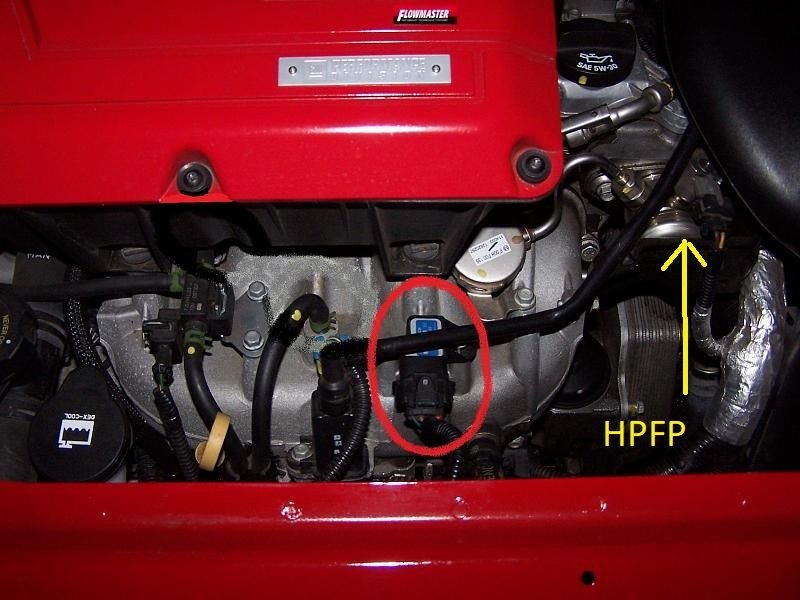

Originally Posted by Oldblue
Does the HPFP have the silencer in it?
Update: the noise is less frequent these days. If it happens, it's only for a millisecond and doesn't occur most startups. Temperatures have come up slightly in NE Ohio, so I don't know if that's a factor or not.
Please elaborate more about this silencer. Is this an aftermarket part? Where is the HPFP located and how do I check to see if this is installed?
Old Mar 24, 2018 | 05:58 AM
Posts: 11,719
The HPFP (high pressure fuel pump) is located just above the oil filter service cap area.
The insulator/silencer is a factory installed part.
I removed my insulator years ago when it got oil soaked. Here's a pic that shows my HPFP without the insulator. (disregard the red circle)
Old Mar 24, 2018 | 10:04 AM
m_ridzon's Avatar
Joined: 01-16-2017
Posts: 384
Lo and behold, my HPFP insulator/silencer is installed and intact, so that's not the issue.
Like I said in my previous post, the issue has been less frequent. So I guess I'm going to chalk it up to weird happenstance and not worry much about it at the moment.
