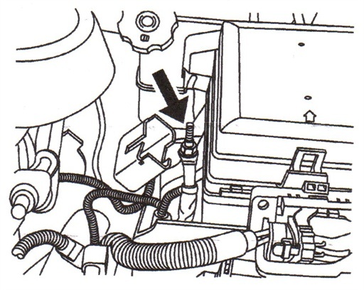

Welcome to the site check the connection of the battery cable at the under hood fuse box. It has been known to vibrate loose over time.
Thanks but its on tight
