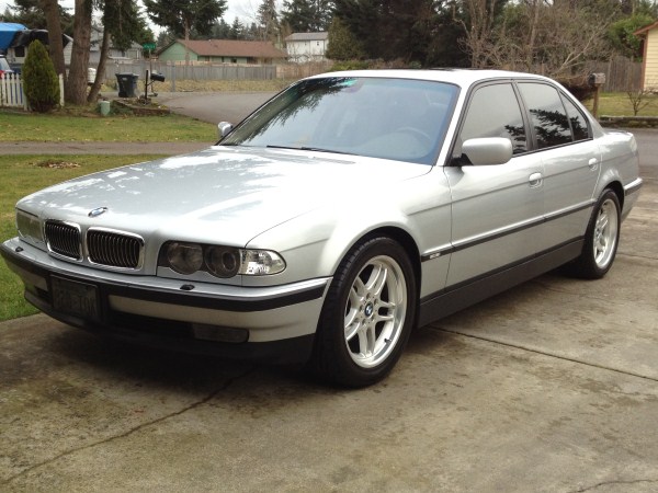

I have two of them "lemons" one needed links at 21k and now my other one started the little rattle deal, I found it amusing that my second one made it to 43k. Replace them with moog greasable ones..50 bucks oh wow.Your wife's might be a record at 90k......
Now if you want to pay more for unexpected repairs, buy a BMW this thing has killed me.
