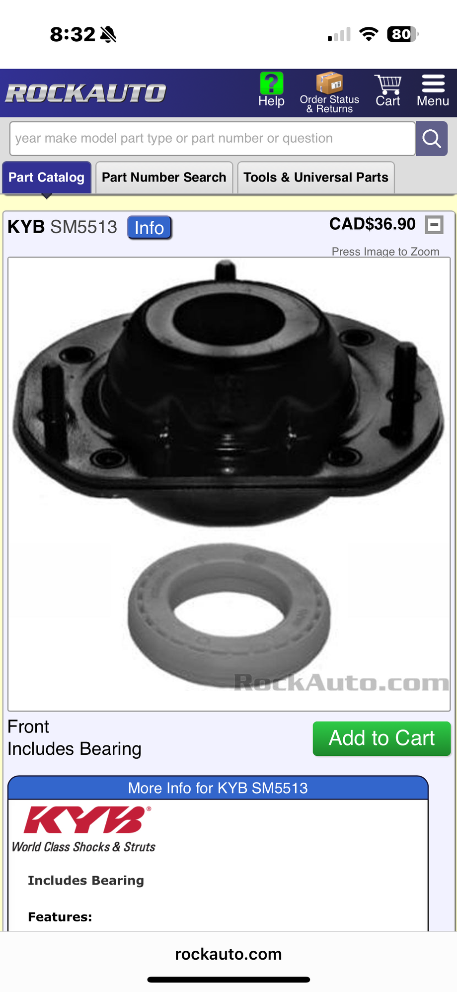

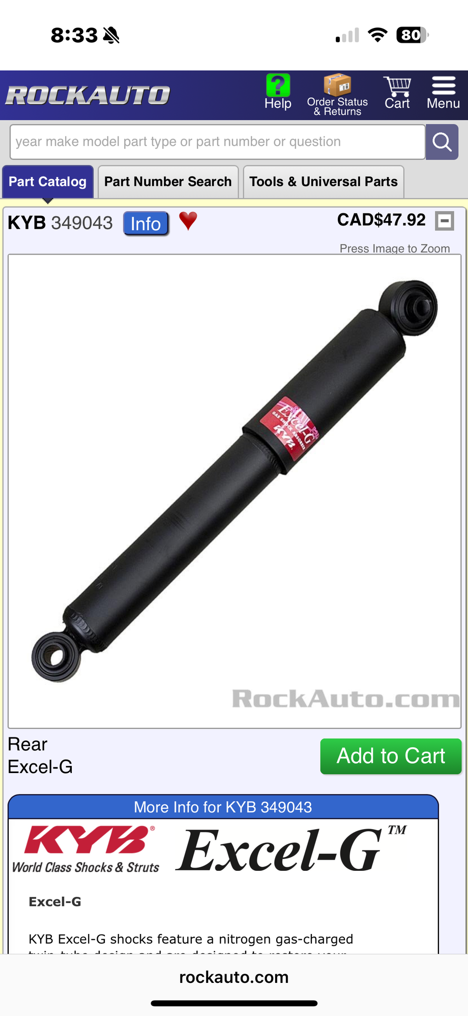

I’ve rebuilt with KYB struts and top plate bearing. I recommend you replace the rear shocks also with KYB
I have a 2LT the ride quality is much better. I have 245,000 miles on the original FE3 front springs.

Sometimes this plate gets rusty and should be replaced, the plastic bearing sits in this
